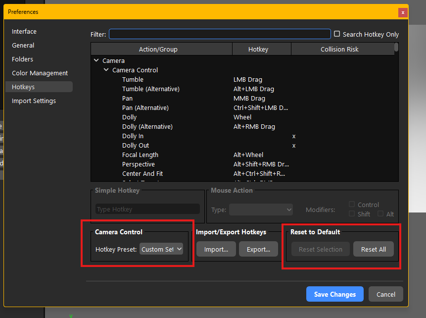

First thing to check is the preferences here, and reset everything to defaults-
Thank you Matt.
Yesterday I did go through the process of resetting all Hotkey settings to default. It did not resolve the issue, so I closed the program, restarted and it was still not working properly. I reset to default again, closed the program, shut down the computer, restarted both and it still, no dice. I rinsed and repeated like a crazy person to no avail. This morning I fired everything up and voila, hotkey functionality is restored. Thank you for confirming that I was barking up the right tree. I look forward to getting back to my exploration of KeyShot after yesterday’s setback!
